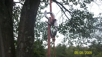

I have to get some pics up, but has anyone eles thought of using this. There is no side loading of biners or of the figure 8. It's a simple install just pull the bit through and clip it in the biner. Set it up just like the f8 system. Just unclip it when limb walking back in, I use a hand cender above the friction hitch. Makes it easier to tend your line wakling back.

OO there is somthing made that would work great in this setup. Kong makes it I have to get one frist before I'd bost about it. As for the piranha it's just a pull of line I used this all day sat and was pleased with the out come might sound like extra work, but it's not. Just open biner and flip pull out to take up slack on retruns takes like 2 seconds. I tried the others and it was how do you say daunting to try and move the 8 and biner up the line even the ring and pulley take some effort to advance. Whit just a sec you flip line out and tend rope, the hand cender is not really called for I'm just lazy, once done with return you just pinch rope and reconnect piranha. I have 2 crane removals Tue. and plan to use it all day and get some pics.

Ok now on with the pics

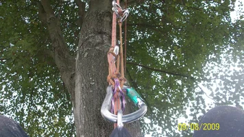

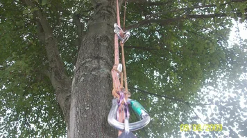

Whats the other line for in the pictures?

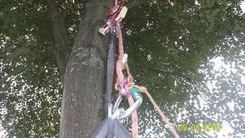

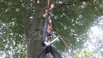

The last picture, would you trust that set up in just a single line ascent? I know it would fail at a competition. The ascender must be backed up and your hitch below would not qualify. Just saying

the other line is my other end of rope tied to the last lead in the pics it was a 3 lead maple crane job. Tied it off spiked up set strap then decended.
Whats so wrong I have a hitch under the ascender? If the hand cender fails the hitch on my belt will grab before it hits the hitch.

What i was referring to was your single line set up for ascension. If the ascender was to fail it would slide down the rope catching your hitch, sending you into a fall. That is why your backup must be above your ascender.
As much as you might trust an ascender, i've seen them fail. Recently too. Didn't grab just slide right down the rope in the middle of ascent. Wasn't going through brush or leaves. Just failed to grab. Thankfully he had them backed up! If that were to happen to you in your set up, they would slide down and release your hitch. Trust me if the climber had that set up when his ascender failed he would have been in a free fall to the ground.
