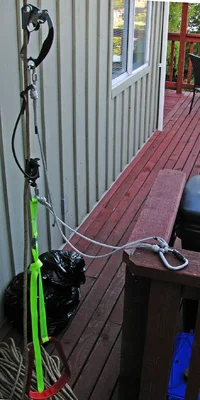

Here's a setup I just made up, I haven't tried it out yet. The black cord is shock cord. I have no idea if the shock cord will be strong enough to advance the lower ascender but I think it will.
With a little tweaking you'll get the shock cord length right.
One change to consider would be to clip through the top holes of the upper ascender and then fun that tether back to your harness. Instead of having the upper tether attached to the lower hole in the ascender. This adds another bit of safety to your system.
