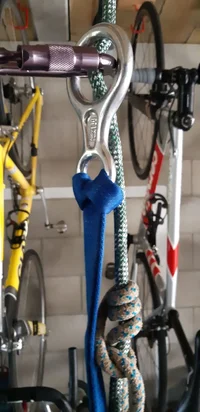

As for adding some friction for descent, here's a pic. With my money, I'd skip the HC pulley and get a rope wrench.

Interesting setup, and one I've never seen before. I guess the problem with that as to my original reason for this post is that it doesn't look like it could be setup during ascent as the climbing rope would need to be unloaded to install. I can install the Munter below my hitch to get down with it loaded, if I forgot a piece of equipment, got attacked by bees etc. I do realize the RW would cure this issue too.

If unloading is a concern, just swap the F8/biner with a prussic. You just need to add more friction so your hitch doesn't lock up. When you reach the top of your ascent, don't load your hitch hard before adding in your extra friction.

The picture you are referring to is showing what Kevin Bingham was climbing on in the older video. You can install it above your hitch before the climb, and it will be ready when your ready to descend. There's no need to install it while your climb line is loaded.
With the amount of slack in the sling, you would want to push the carabiner and figure 8 taught before you begin your descent. Much like climbers would use the ropewrench ZK1 with the soft tether.
Wouldn't it exert as much resistance going up as coming down, fighting the ascent? In the video it looked like Kevin was gaffing up an inclined tree and slack tending as he went. I'll give it a run and find out.
I learned during practice, as you mention, to loosen the hitch set a bit, before descending. They really want to bite that single rope.
Prussik; that's a simple and effective idea. I do carry a couple and a sling at all times for self rescue. I have experienced why you say don't load the hitch hard before adding extra friction.
I just thought of a question about this tethered 8 setup. Is the biner held in hand and manipulated to alter the tension on the rope passing through it? Would you advance it by hand as you climb if installed pre ascent? This occurred to me because of your comment about it being the origin of the Rope Walker.
