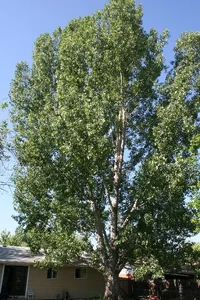

So, 90% (at least) of my removals are Siouxland Cottonwoods due to Cytospora Canker. Setting a nice 60'+ central T.I.P. is key to dismantling the tree efficiently. On the ascent I can clean out small interior stuff and I can limb walk out and create nice tip ties for utilizing the GRCS to lift some limbs out. Most of the time I can work the whole tree with one T.I.P.
I never really thought about it, but for the reasons stated above, that's why I don't spike as often.
The photo is a tree I took down yesterday. It was 43"DBH, 75' high and a span of 50'. (The tree was showing early signs of Cytospora Canker, so they wanted it down now to plant a replacement). This is a little larger than a typical removal, but the principle still applies.
