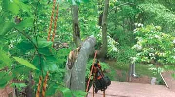

The subject of prouts have come up (joke) lately and I just ran across this pic. The srt rope is around a 10-year old sprout. Branch was stubbed back to a node after ice damage.
It didn't occur to me while riding up that I was hanging my assets on an epicormic!
That tree looks kinda sketchy, imo!
Yes, I got the same feeling when I saw the saprot on the upper side of the limb. Beeches get sunscald so easily after storm damage. But it stood up to the bounce test, so no big worries.

So are those sprouts, or watersprouts? And how about that "weakly attached" myth?

I dunno, Guy. Retrenchment of geriatric trees is your predilection, not mine. I reckon those sprouts are "generally" undesirable unless extending a tree's lifespan depends on promoting their formation.
Guy, in the A300 excerpt, what does "mitigation potential of the site" mean, the ability to have potential targets removed?
In my limited experience with the term "watersprouts", orchardists used the term for small-diameter vertical sprouts. I don't find it a useful term.
Well thanks tom; maybe it's because i'm old enough to collect SS that these geriatric comments get me close to oph pysst...watersprouts have strong vertical habit and no collar/buttress; Very different than the sprout that my lifeline was on.
sprouts form when the tree needs them; how is that undesirable in any tree? *water* sprouts is like 'geriatric'; a bias based on a myth at best..if a tree is busted up by ice, it's all of a sudden 'geriatric'?

well no; that's the difference between waterspouts (strongly vertical, ruin form, work against the objective) and sprouts. but you're right; I did kind of overstate things there...my bad.
I hope you'll agree that the sprout that the wraptor is hanging on was desirable, though.
That Wraptor sprout is very nice!
And I will quit referring to sprouts as watersprouts, (unless they happen to be watersprouts).

As watersprouts in the landscape occur mostly on Rosacea like fruit trees, crabapples plums etc, maybe that's where the term should stay. In the current pruning standard, watersprouts and epicormic shoots are called synonymous with 'sprouts'.
That should change, as it tends to send the wrong message, that no sprout can be trusted. Which is one more reason why it's
