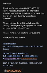

I’m out. They’d have to get to the 2k ballpark for me to consider buying one. Time to look at the Rollgliss thread again.
Liability driving the price?
Same. 2500 would probably be my absolute max with everything included, even sales tax and whatever. I know that it would likely eventually feel like I got my ROI, but there's a long list of things that cost less than 8500 that I'd likely get more value out of, so I'll keep buying down that list for a long time before I get to this one. Shit, I'll probably attempt to DIY something first, as there's a documented functioning design here already. Thanks for asking skylotec for us Muggs
I'm not surprised by that pricing, but it's certainly beyond what I'd spend on such an occasional use tool for my needs. At 5k I'd seriously consider it.
