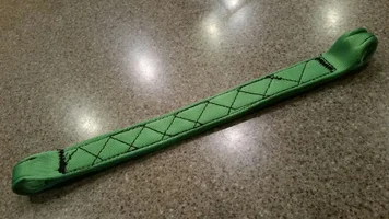

Bump. After getting settled in a new state, I am finally getting back to some of my projects. The goal of this one is to develop a sewing pattern for 1" climbing spec tubular webbing, that meets the following criteria:
1. Can be replicated using a home non-commercial sewing machine.
2. Can meet or exceed the breaking strength of the material
3. Can be reliably reproduced by others with an expected strength based on pattern and number of stitches.
After reading everything i could get my hands on, I developed a sewing pattern that uses 45 degree stitching with #69 polyester thread, to maximize crossing the warp and weave of the material with each stitch. I start with a square frame around the stitching area, then fill it with diagonal lines in both directions, keeping the overall stitch density down to avoid over stiffening the fabric and weakening it. Finally I sew small bar tacks on each end of the pattern to protect the end stitches. The ends have been sewn to make them fit on an aluminum ring better.
This 12" strap is a replica of one I made to move the knot away from my Captain, I sewed directly to the hook shackle on one end, and to an aluminum ring on the other.
First break test came back today from @yoyoman
For a first test I think this went really well! The stitches were definitely shredding, but the strap broke first. A more concerning observation is that a strap rated at 20kn broke at 16kn, that is something else to explore.
I am not ready to call this a complete success but I think with some more tests at different diagonal stitch densities and strap configurations this could be a winner.
