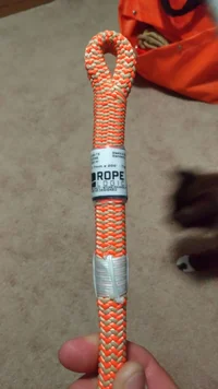

Hmmm. Whipped at the standing end of the splice rather than the throat of the loop? I'm new to splicing and I usually stitch and whip at the throat. Why the standing end?
The throat is too tight to lock stitch. Trying to force a needle through that part of the rope will damage to many fibers. It is also only needed until the rope is loaded. After that it is just decoration. A proper double braid eye splice should not slip once it has been loaded. If it slips at all the dimensions of the splice were wrong.
Here is a db eye splice from rope logic on yale Aztec. It is at the base of the core taper. The lock stitch is for locking the core to the cover. It is not necessary to capture the taper in the lock stitch on a double braid. That being said; if you can do it and not damage fibers, it can't hurt.

Thanks for the info. Good to know. It does seem like sometimes I have to work the speedy stitcher pretty hard to get it through the throat of the eye. I might be damaging fibers when it's that tough to do. If it's tough to do, I'll back off the throat area. I do like the look of the whipping at the throat, but then I would only have to bury the whipping cord ends.
Speaking of lock stitch, when using a Speedy Stitcher (a.k.a. a painfully slow stitcher), I bury the lock of each stitch per the directions for the SS. Is this OK or should I run the stitching twine all the way through back and forth like the Samson directions call for?

I don't think it matters that much. I use the speedy stitched method, knot the ends, bury the loose ends, and then use a separate thread for whipping over the lock stitch.
