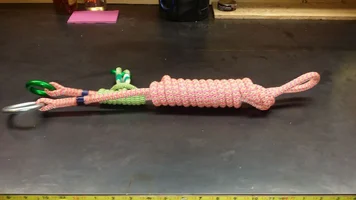

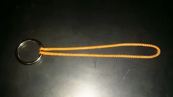

Here is a fun project if you are a bit of a masochist and have some scraps of 16-strand laying around. Building the first eye is easy but the second eye is more difficult because you have to pull the second tail past the first tail inside the rope and it is a bit tighter than the usual bury with 16 strand. I used a a 32" long homemade wire fid to do the pulls and you have to really reef on the second tail to get it through. Once you get the tails through you do the usual taper and bury. This required a 100" piece of Arbormaster and the finished friction saver is 36" long. The second photo shows the splice before the tails were tapered and buried. I could have done this better - notice that I did not get the bury exactly even on both sides. Will try to do better next time.
Looks awesome! You just remove the core entirely? I'm going to have to make some..
