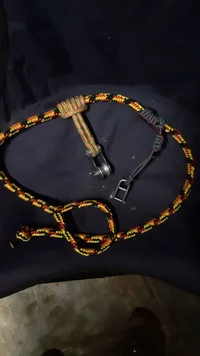

Heres a quick rope guide i made for a co worker. He chose the cordage....which he is no longer allowed to do, was a pita to work with.

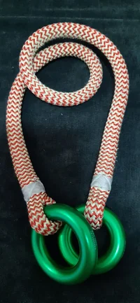

@Daveyface; Please forgive my ignorance. What is the purpose of the large loop with both ends attached to the same ring? Maybe to pass the loop around the stem and the bight through the ring to form a cinching anchor? Thanks in advance.
Tim
Tim
Probably just a large ring loop for whatever... Could be used as a prusik on a larger parent sling like the 14mm Sirius one in the picture... Or girthed like you referenced.. All sorts of uses..
Yea pretty much ran out of stuff to make and figured it would be useful. I imagined it as a Prussik for tensioning anchored speedlines or pull lines. The line would go thru a ring on the anchor point then thru the loop ring that's hitched to create a quik 2 to 1. It has many uses but I just had the stuff to make it on hand
