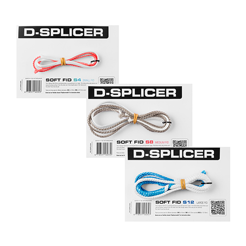

Right right.. like trying your first with Tachyon.. I personally think the best advice for a first time splicer is a soft fid or anything tube like that is thin, slick, flexible & will finger trap around a core when pulled.
I had the hardest time with splicing until i used one, after that, 90% of cordage we climb on is a peice of cake & most troubles I've read about here could be solved with one vs hogging out more material/strands..

Whats that, the soft fid?
I've never bought one & usually make my own, but i think D-Splicer offers one..
Yeah here's a product page with some pretty clear info on instruction way better than I could explain for you.
Also, it's pretty much same principal as wesspurs basket fid..

No prob bud.. you can find that expandable sleeving for dirt cheap on Amazon. It's slick & slides real nice through buries/etc.. of course you have to thread it through before hand with a fid of sorts, but it just slides right through with no trouble.. & in the end makes the real bury a piece of cake.
