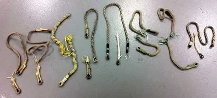

Ha! This thread has over 1400 views and only 8 cords sent in.
That in and of itself shows me something. (lots of folks are eager to contribute their opinions but few are willing to stop by the PO on the way home)
Since there were only 8 it would be really cool to see the pics of all 8 after breakage. I think I might be able to pick out mine from the 3 beelines.

To me this test supports the idea that spliced hitches are plenty strong and if I read this right, the splices held and the cord failed in section. That's great news!

Interesting that the beeline looks to all have breaks in the core but not the shell and then separated at the splice. Would a grizzly splice yield different results?
i broke a beeline and it broke right at the end of the splice. that particular splice did not have a taper. I have since been putting as nice taper in my splices. I have seen proffesionally spliced beeline and HRC with out tapers, thats why I tried it without a taper. I broke it while it was being used in a sled hauling rig out of a backyard. It was eye to eye and a truck was involved but it was the weakest link
I would be curious to see the breaking difference without the taper or with a taper.

THANK YOU for your commitment to safety in general and for doing these tests. very valuable info. I think bing mentioned some tests where beeline broke right at the end of a non-tapered splice. Kind of looks like that is what the grizzly spliced pieces did, unless I'm missing something.
