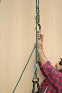

Try the arrangement shown in the attachment. Discard the spliced cord that has the thimble in it, and attach the carabiner on the end of the climbing line directly to the saddle. The rope in the photo has an eye splice, but you could use a scaffold or other attachment knot instead of the splice. This arrangement places the Scaffold knot close to the D ring of your saddle, away from the friction hitch.
If you need more photos (step-by-step or closeups) or more description let me know.
Thanks for the suggestions, Rich and Mahk. I tried the modified method you showed in the picture and it worked pretty well for me. What sort of hitch are you using in the cord to attach the small caribeener to the climbing line? I used the Kliemholdst (way bad spelling, sorry) and it worked ok, though I could see room for improvement.
Actually I wouldn't call it a 'modofied' method, at least not a modified version of the Anchor Bridge. It's basically a quick draw and is borrowed from rock climbing. I've used it for 8 or ten years in this application. What I did borrow from the Anchor Bridge is girth-hitching the extension/quickdraw to the D ring (great idea Rich!) rather than attaching the extension with a carabiner.
The hitch is a two wrap, four coil prusik. The attachment shows a closeup.
Initially I wanted to attach the brass snap just to the string, and leave the string on the line whether the system was in the extended or in the short mode. But, the string could fall off when the system was in the short mode so I added the key chain carabiner to keep the string on the line.
