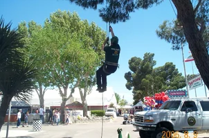

Talent with a camera is like pricing art! who is to say what the price of the work should be.
Just take a picture and post it if you have a good and new climbing system we can make up our own mind!
talk about in climbers chat 5pm pst
www.wildernesstree.com
sorry to miss the chat tonight rob. Did you perchance get a chance to check the pics on pages 1 through 6 regarding this climbing system?
