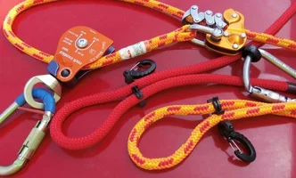

I got 4 of the ScubaClips in the mail, today. All plastic, except for the SS wiregate. Snagging the lanyard loops during a swing might break them, but they seem fairly tough.
Couple of pics with some different lanyards/rope...
7/16" SuperStatic lanyard.. very easy in/out... in fact, perfect.
1/2" Petzl JANE lanyard.. still easy to get in/out, only slightly harder than the 7/16" lanyard.
1/2" Yale XTC Fire 16-strand climbing rope was slightly harder than first two, but not much harder.
13mm Sterling static kernmantle, 100% nylon (rescue rope) that I use for ascent is a tad fatter than most 1/2" lines, and it was a little difficult to get it in/out of the clips. I don't think I'd want to use anything this size in them.
I also tried the 10mm Armor Prus lanyard, and it was very easy to get in/out and moved through the clip very easily. All of the others will stay where you clip it and won't move through the clips unless you intentionally move the rope.

Good first impressions. Wonder how they'll hold up?
Yeah, I'm wondering, too... I'll put them to use right away and report back if they break...
They clearly won't hold a lot of weight, with the swivel parts all being plastic, but it is pretty good plastic. I don't think weight will be the issue, though, I think snagging the loops on branches is probably going to be an issue. We'll see. I do like the way the rope goes in and out much easier than the colored plastic gecko-toe style ones from TreeStuff.
