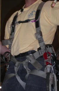

Marc H, I agree with Sohner's assessment of the BryDan saddle. For pure climbing, in my opinion, it is one of the best out there. I used one for many years. But I noticed that you are from Colorado and if you are planning on climbing through all the seasons, it may not work for you. The adjustments needed to go from summer weight clothes to winter weight arctic suits are just not there. I faced the same dilemna when I moved to Montana.
