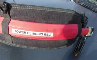

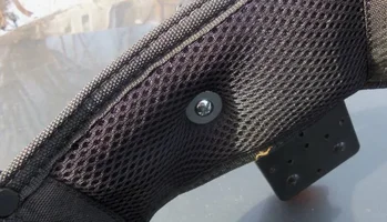

A nylon or polyester loop runner can be used to add side D's to any saddle using either bow/anchor shackles or Petzl Ring Open type rings. I do it to convert Petzle Caladris big wall rock climbing harnesses into tree climbing harnesses. Those are in a trailer that is currently buried under a foot or so of snow, but the photos below show the technique. This is an ordinary heavy duty tool belt converted for climbing comm towers under 50', but you can see how I did it. I used a ridiculous crane sling that is overkill, but I had it on hand and it was the right length.
The sling is bolted to the 2" structural belt in four places (you can see them under the shrink tubing) and all of that is bolted in two places to the padded inner belt. This is all to keep everything in place so it doesn't shift around. The hole through the sling and belt are made by running an awl through them, followed by a soldering pencil to melt the edges so things don't fray.
