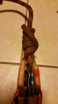

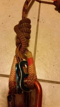

Tim, what problems are you encountering? What cords and rope are you using? I find any Yale 11.7 rope to be great. Yale 10mm hitch cord, silverstreak, beeline etc is a good match.
Tim, some times hitch problems come down to dressing the hitch. The same hitch will work different when dressed differently. You will see climbers instinctual ly dress their hitch as they climb keeping it loose but ready. Easing into your stops will keep you from jamming. If your slamming to stops then your hitch will jam. On longer descents, keep it smooth, use your other hand for extra friction or even your foot, leg or but.
Watch how your hitch operates and coddle it. Think of your shoe laces and how important it is to keep your boots laced up right. Lok how care fully a hocker player laces up their skates. A hitch is the same way. Be easy on the clutch.

Hey, Ben! Thanks for your interest and recommendations, they are greatly appreciated. It has been quite awhile since my last opportunity to climb, so it is not like I'm currently having issues; I am more just discussing what has tended to pertain in the past, from recollection. (I had been working my normal day job for the past few months, many hours, not much spare time.)
This thread started by moss in part because of a post I'd made in Reg Coates' thread about "Rope Wrench, Without Incident" basically sums up my issues.
http://www.treebuzz.com/forum/threa...inding-with-the-rope-wrench-on-descent.32350/
A bunch of great hints and tips were proposed in this thread, but I have not yet had a chance to try them out. I just got back from working on the road for an extended period of time, not arb related, and I have a bunch of personal stuff to take care of before I can take the time to climb just for fun. I am at present not a working pro arb, just another amateur.
I guess I make time for the arb forums, just because I'm constantly interested in learning more about all of this stuff, even when my opportunities to climb are few and far between. My hope is that I might learn something new that I'll find helpful when I do get back into it with intensity. So, my questions are really about doing the research, and looking for answers.
Thanks for your time, and your suggestions.
Oh, and I never did answer your questions. It has been awhile since I bought the rope I use my Rope Wrench on, but I think it is a 10.5mm Mammut rope, or thereabouts, and it is a dynamic, "dry" rope, I think it's called. Gorgeous stuff. I think I was using 10mm Beeline on it, in a Knut hitch. (Gear is outside in the car, just a bit out of reach, at the moment.)
