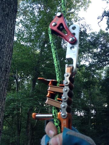

I'd like a quick on/off tether for the same reason. I have a vision in my head of an aluminum tether that I'll leave on the wrench side and I'll make a large hinging gate on the uni side that I'll close with another slic pin. When the new wrench comes out I'll make one and post some pics.
Finally got around to making a rough version.
5/8" x 1" aluminum bar stock tapered down to the width of the rear part of the new wrench. For the time being I tapped a hole for a bolt to retain the uni. When I make the final hard tether I'll raise the opening that goes over the uni headstock and use a 1" quick release pin to retain it.
So far the only change I want to make is making the top tending hold closer to the wrench and offset toward me. Other than that, it's quick on and off and I'm happy.

Awesome looking tether! That is exactly what I'm looking for.
How long did it take to machine that bad-boy?
What sort of differences in design do you see necessary for use with the original RW?
