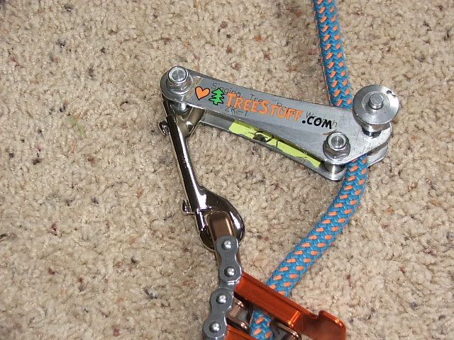

Sorry, Scrat, I forgot to reply to you. The shoulder harness is a Petzl Torse. Simple light weight and inexpensive. I got mine from Wesspur for about $21.
The tether from the Uni to RW is just hand sewn with a lock-stitch awl. Even though this is in fact, very strong, I have more leeway in this setup compared to most Rope Wrench/hitch combinations. The reason for this is that the Unicender is not only safe without the RW (like a properly tied rope hitch) it remains fully functional on a single rope in all ascender/descender or work positioning operations.

Hi, Ficus. There are a few things to report. I have tried several different tethers and have concluded that for the full benefits of this combo, it must be stiff enough to function as a hinge with very little side movement. Set Up in this manner the RW works as a rope trapping guide, stopping any possibility of the rope falling out of the top cam on the Uni. The rope can only be forced out of the Uni during off angle slack tending but with the RW on the stiff tether this just cannot happen.
You can easily advance without a chest harness, like with climbs up to a new position on the Pantin or foot-lock but for climbing the tree a harness will keep everything in the auto-slack-tending mode ( at height the rope will fall through on its own ) and stop it from dropping below your bridge and being always in the ready position.
Dave
5/8" nylon web with aluminum screw rivets, stiffened with superglue.

I prefer to take the Rope Wrench off during ascent so this is my tether, 4 inch double snap:
...What is the measurement from the center of one eye to the center of the other?...
The shortest I could go is 3 3/4". When the RW is folded down it needs to be close to the top cam on the Uni but not so close that it interferes with normal Uni movements.
Dave

I don't have a GoPro and Dave has had more experience with this but I think the ascent is very smooth. Jamin how do you normally ascend with the Uni? With the double snap and removeable pin if I feel like taking the RW off it is very quick. I think Dave's system is great with the ring sewn in to the top of the tether. I really like the RW, but with a hitch the cord seems to get bunched up and can make the ascent annoying, not so with the Uni. I think this is the perfect combo for SRT.
