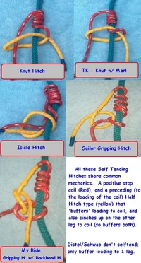

They also like Tenex for Friction Hitch. i tell ya it grips good, high strength(5k in 3/8) and flatttens out to maintain more high strength and friction area. i like it in a (Sailor's) Gripping Hitch; but finish with backhand hitch. But what they call a Becket; i call a Buntline/Clove to self to form shrinking eye??
i'd think that unless you are over a fire pit or electric line; a little slip and elasticity to keep forces low on support, connections, bod etc. would be desireable. Especially in DdRT/ doubled line that is less elastic than mountaineering line that is used as a single line(doubled line; always less elastic than single line; becuase less load per leg of support in doubled). So, perhaps when the greatest risk is impact loading/fall; the slippier knots they toss out are better??
Great numbers on Scaffold/Dbl. Noose/ Double fisher persons. i like mine as an Anchor to self to form shrinking eye/turn not crossed. So lean more towards knudeNoggin's naming of Double Noose.

Spyder, I know what you mean about the benefits of hollow braid like Tenex. However, I wouldn't recommend it for tying friction hitches, as the braid thickness is thin and has no core for strength. That means easy to burn and bust with slippage/high speed descents. Thinking of what happened to Rupe in the ETCC, that type of slip would probably led to a fatality if using hollow braid.
Worse than this, some short spliced eye - eye lengths have the splice tucked back into the core. This has fooled many into thinking it is a load bearing core, rather than loose wadding to give a round cross section. /forum/images/graemlins/crazy.gif

i only tie eyes; with a double noose/anchor to self. i'm pretty light and don't burn cords a lot. But, i also think that the loose weave and flatness might offer less insulation/ heat holding capacity and breathe more.
i especially like Tenex (not shown in pic, to give more dramatic color) when it is cord device for Icicle or it's similair brother Sailor Gripping Hitch.
