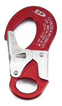

Hey Rugger, which snap did you get from Fresco? They now have a beautiful Climbing Technology (CT) snap that I know Sherrill does not carry. Everyone that I show them to loves them and quite a few guys on this site use them. Let me know if you are interested.

I have been trying to locate a picture of it with no luck so far. They are not in the CT catalog online, but they are in their product catalog and that I can send you. I will take a picture of one and try to get it up soon.

good lord, it took awhile but I finally found a pic of this snap. Sorry for the size of the pic.

Rich got me one of those CT snaps and I LOVE it!!!
The size is just right, large gate opening and the shape of the eye end of the snap fits right into my hand. It is a very easy snap to use.
