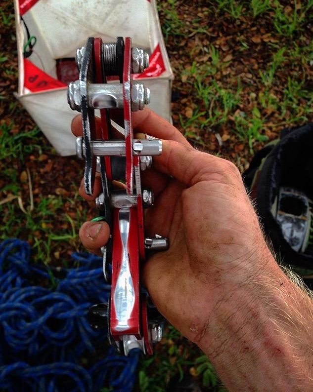

Yeah I'm in that category. I'll just keep the Kiwi's on at that point. Oh so hey, how bout that rope runner? I'm already replacing both bollards and the pulley. Ive done the once rotation but according to the inspection sheet I should replaced them due to wear. I guess it lasted a little over a year. Is that "normal" lifespan for the bollards? It may fix my angry release under load. I may just rotate the bollards one more time instead of a switch out. Depends on how I feel comparing old to new. I'm that guy who tosses saw chain that isn't perfect and isn't fixed back to "factory" after I touch it up. I hate working against the saw and see no need to sharpen it and file rakers until theres nothing left. The point being, I got my use out of it so if I have to replace it, no biggie.
