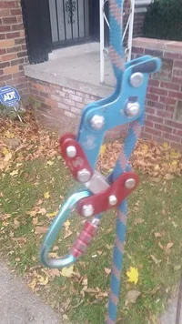

Akimbo'd my runner a couple of days ago. Seems to work pretty well. Needs some refinement. Not as slick as jaimies easy on easy off, but it works pretty good. Eliminates the drop hazard and I notice the loss of a friction point as far as smoothness, it Needs a pulley. Other than that, it's a fun little experiment.

Did you try it at all with the friction body on it also? It looks awesome!

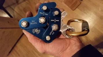

No, I just cut it out. Messing around really. Nothing I will be selling or pushing. Just seeing what different bodies do. I boned my runner a while back too. Over the winter.
