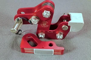

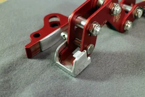

Added a "bump" similar to yoyoman's and only had a chance to try it in the basement. It helped but didn't go as far as I would like.
I added monkeylove's tubes for comfort and the combination was considerably more comfortable in my brief basement trials but I couldn't get the rope on and off without removing the tubing.

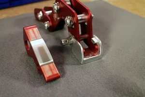

So....I hacked out an aluminum 'pad' that is easy to take on and off, yet securely attached by the Slic Pin. Seemed nice during basement trials. Hopefully I'll get out to give it all a good test tomorrow.

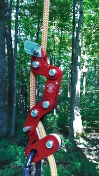

I gave the mods a good try out today. Up 85', back to ground and up and down 30' several time trying different adjustments on the adjustable bollard.
These changes have greatly eased the perceived pressure required to release the RR and make 'jump free' starts and control from inching down to so fast it scares me back to inching quite nice.
The finger pad prevents the uncomfortable digging in on my soft desk jockey fingers and appears to be the answer I was looking for. Much better than the Plasti Dip I had previously tried.
