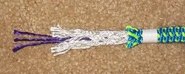

NER and Sherrill were definitely using the term "triple braid" at TCI. I do agree that it is misrepresenting what the rope is. Here is a pic. of the cores.
