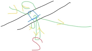

Excuse my kinderdoodle. This is the quickie retrievable redirect. When setting, start by putting the quickie on the line above the branch you plan to use for the redirect. Then wrap the quickie to the backside of the branch from the top (anchor) side. With slack in your system, wrap your line around the bottom to meet the quickie on the backside of the branch. Put the line in the quickie. This is a choked, non-retrievable redirect. To make retrievable, after installing your line above your system, take the tail below your system and include it in the quickie, making sure that it won’t get pinched when you weight your system.
To retrieve, remove your system and pull the tail to remove the bight you’ve been climbing on. The quickie will be attached to your line on the topside of the branch, so be mindful as is slides down to you.
The drawing shows what it should look like on the backside of the branch. I like this trick for stems that don’t have unions for other redirect styles.
The first time I demonstrated this redirect to my wife using my arm as the branch, the release of the bight sent the quickie whipping around into my cheek bone, splitting the skin.

That is a good, gear light, retrievable redirect. I rarely want one, but when I do, I don't want to have to try to explain what the hell tools I need to my ground guys.
