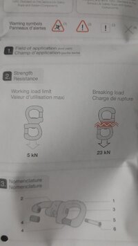

Take this as you will, but Omni block style pulleys are meant to be stationary. Any time there is a chance that the button could be hit in movement, it should not be used. For this reason you probably shouldn't use it on your bridge as life support. I checked into this when a local competitor wanted to use one as part of a friction saver.
To substitute, you could install a Notch rook on to your bridge and get the same benefits.

I appreciate your concern for my safety and welfare but when my Omni Block 1.1 returns from its recall it will almost surely go back on my bridge. At this time I figure that the odds of something pushing the recessed front plate release button and the plate turning, and my bridge getting unhooked or shock loaded before I became aware of situation are too low to offset the advantages and convenience of this device as a bridge attachment.
