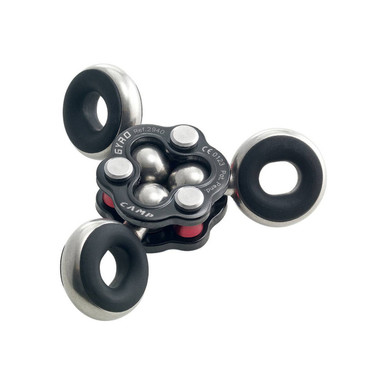

Ive been using the Omniblock mini 1.1" on my bridge for years. I replace it every three years and replace my bridge every 6 months even though it never shows that much wear. I wouldn't consider going back to anything else honestly.
A few months ago I started using the Camp Gyro triple swivel on my bridge. So far I have found it to be a big improvement over a ring, single swivel or any combination setup. The stainless steel rings move smoothly on the bridge and the whole thing takes up very little space on the bridge. Phenomenally good when running two systems.
Do you take the grommets out of the eyes?

Well, for what it's worth, I have been using the Camp Gyro since last November, a full year. It still looks and functions great and I like it just the way it is. Wouldn't change a thing.

So , I might gonna put Titanium bearings on New C.A.M.P. GYRO... Lol :LOL: I might change all that climbing gadgets all that to Titaniums ! Lighter !! stronger!! comfortable!! Safer !! Long lasting !!! Gawd Damn it !!! C.A.M P shouldn't be losing on Notch rook ! !!! But I'm connectin' notch rook with Camp Gyro with carabineers... But it's just not so smart and slim !!! It's just too much ! We can shrink it back into one !!!! Smooth , Smaller Convenient , Sturdy, Safe , lighter , Comfortable , Well balanced.

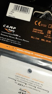

  • Tensile Strength: 5,845 lbs.
  • Working Load Limit: 674 lbs... Well, this numbers that Ive just pulled out are not from CAMP Gyro . It's actual copy & paste from DMM mini Swivel that has been recalled. Whatever it is, we just needs to be cautious around climbing gears.
He wasn't talking about your input I don't think hahaha
Working Load Limit: 674 lbs... Well, this numbers that Ive just pulled out are not from CAMP Gyro . It's actual copy & paste from DMM mini Swivel that has been recalled. Whatever it is, we just needs to be very cautious around every climbing gears. Thanks God so far nothing happened with CAMP GYRO yet as its seems like.
and that numbers are just same as this swivel down below...

I have climbed on a Sequoia for years, and never had a problem clipping directly to the bridge. For that matter, I have never owned a saddle with an installed bridge ring. I did put a swivel on my Sequoia last year, simply because it makes it easier to orient the zigzag I use when I am hanging off a crane. Otherwise, I don’t really see that a ring is particularly necessary.
I have a Sequoia as well and don't have a ring or swivel on it (as of yet). Never climbed with one either on any other saddle. I've always preferred clipping directly into a bridge rather than a ring or device.
I forgot who it was, but I'm pretty sure I remember once seeing a fellow buzzer saying something along the lines of "what's the difference between a carabiner and a ring running against the bridge" in terms of friction and wear and tear.
Although I know a lot of people utilze them with no issues, just something I haven't gotten around to looking into.
