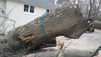

that's an 1100 lb piece of oak..... I think the true blue should handle your side jobs just fine...
and here's a big tulip top coming over on true blue....
