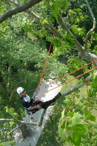

I am blinded by the M talk cant see how
"simple" it is how is the eye splice constructed .Is it about a three ft section of rope with a splice on each end and just girth hitched around the redirect point? with a small eye and a larger one (like a fs strap?).And after which end has the biner clipped on .somebody draw it ...........robdog..........slow ain't the word
Here's a shot of Nicola in Italy practicing it in a 148' London Plane tree. /forum/images/graemlins/cool.gif

SWEET! nice big syccamore.Well I gotta try it and see looks like the pic shows the climber just throwing the clip over the redirect point .If so the bark will get torn up with me on the load.Hope I am wrong and if not a regular FS can be installed,but in my ponderosa trees with the big spreads here we wont worry about tearing up the bark.Thanks MARK AND TOM............ROBDOG
(I think I see the M )

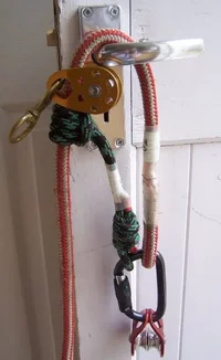

rupe's redi
[I resized and cropped the picture and made in an attachment so that dial-up users can load faster....Tom]
Re: retreivable redirects
Well, its there! Couldnt get it to work as an attachment so its embedded. Sorry about the size!
The throwline should be attached to the snap on the left for remote retrieval.

the zing it goes on the dog snap so you can use the pulley to pull the prussik right off and the whole thing slides down to you.....sweet
Is this the setup where the end of the redi, the leg with the friction hitch/pulley/snap doesn't have a stopper? The slack tender on top is used to strip off the friction hitch..." Is that right?
Thats right Tom. Might limit its use slightly, an accidental premature retrieval, say the throwline getting caught on a piece of brush, would result in a surprise swing.
