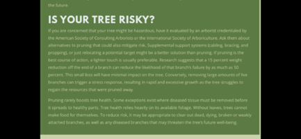

@Daniel your video talking about how reducing a limb by 15% can increase its strength by 50% has had me thinking about it for a few weeks now. It makes sense. I learned full-tree reduction in my first couple years in the trade, from an Englishman who was very good at it. So many of these trees in the city are hardier than we give them credit for. These blanket rules that are taught to new tree guys are just way too simplistic. Such is the way that most things are taught I suppose.
@Daniel
Hey Daniel, just curious where you got that 15% to 50% from? It makes sense to me and is sort of in line with some of Frank Rinn's work regarding canopy reductions and wind but have yet to find any research that states that in regard to individual limbs. I know one guy that made the same statement in a publication but he doesn't know where it came from either lol. Thanks
I don't recal ever making such an assertion.. Does 15% mean 15% of weight or of length off the tip? and how would anyone ever measure when a branch became 50% stronger.. While those numbers may sound good, they don't have much meaning in reality..

All good thanks, I wonder where Muggs heard it. Here's where I saw it, thought it was a strange coincidence as was wondering if there was something to it or if a rumor just got started somewhere. I get that it doesn't mean much in the real world up in the tree pruning but it doesn't hurt to have some research to back decisions and explain reasoning in a report or to a customer.
