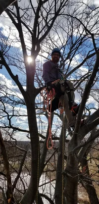

Update using drenaline all day. Had to adjust while in the tree from c4 all the way down to B2 after I wore the rope down a bit. By the end of the climb it was working really well
