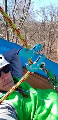

Slapped the Akimbo on my All Gear Rocket line today without changing any settings from my Scion.
