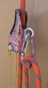

If I ever climb using RADS I use this setup.
Adjusting the cord so that top of the Shunt is no further away than arm's-length when hanging keeps it available for emergency descents.
I don't use the Shunt in this setup as a second attachment point either. If I want that I would use a shelled cam like a Microcender below the friction device.
The pics were taken years before the Eddy was even dreamed of. At the time the I'd filled my criteria for a descender. Now, Eddy is the best choice.
