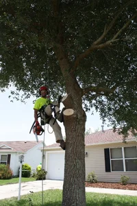

Here is this summers pruning. I removed the lower three branches. Nothing else was pruned.
I will remove the lowest two branches below my flip line in the future. These were shoots that developed from the initial pruning cuts.

Wow--huge cuts! But good vigor and high vitality; you might get away with it.
Thanks for following up! What's the plan for building structure in the upper crown?
Guy - Yep. Those lower limbs took off. I would not do this with a soft wooded tree. These Live Oaks seem to handle the cuts without decay if two things are not present. Recent construction damage and topping. I anticipate full closure by the 4th growing season.
Two of the original upper cuts are completely healed and the large lower inclusion is one year from full closure with no indication of decay.

Guy - the upper crown has good structure with a central leader. My plan is to inspect and possibly prune the upper canopy during the dormant season of next year. I will be removing the lowest two scaffold branches at that time to establish the permanent canopy.
The end game will be to have a Live Oak in the front yard that will extend in all directions. The canopy head will be targeted to be 60' by 60' tall and wide. I would like to extend the tree over the road with an elevated height of at least 25 -30 feet. I would like to design an arch over the driveway to frame it. On the house side, due to crazy home insurance requirements at resale, I am thinking of running main leaders just outside of the vertical plane of the home or cutting slightly over the corners toward the back of the property. I will design the main canopy upward over the main part of the house keeping in mind to have reduction available if the insurance gets squirrelly.

The next crown raising took place to achieve the target hight of the canopy. One disappointing discovery was a double inclusion within the canopy on the driveway side. I was hoping to keep the lower intact but ended up subordinating them both leaving a hole in the canopy over the driveway. I will have to subordinate the vertical growth on those limbs next year, possibly removing the center included limb.
The tough part on removing a middle branch is getting it to heal properly. This is a feat that is hard to achieve unless it is a crape myrtle. It may be near impossible so keeping these limbs small and having the canopy grow over will possibly be the best solution. I will review next year and adjust accordingly.
Nice closure, but it has a ways to go, with or without the darn squirrels.

My guess is 3 more years on full closure. I should have listened to you on the upper canopy pruning and I could have mitigated that triple years ago.
