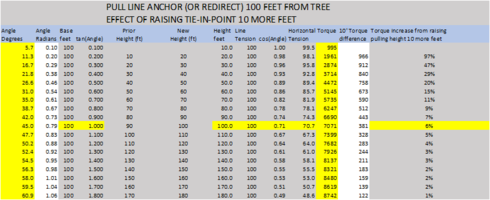

How much benefit will I get if I climb up an extra 10 feet to set the pull line?
Or,
If I can install the pull line with my pole saw at 20', how much benefit do I get by climbing or using throw ball instead?
The attached spreadsheet answers the question: how much more torque will I get if I raise ten more feet the tie-in-point for the pull line?
Since I've assumed a 100' distance from tree to anchor, this can be read as percentages.
- If anchor is 60' from tree then how much extra torque is achieved for every 6' increase in height of tie-in-point?
- If anchor is 150' from tree then how much extra torque is achieved for every 15' increase in height of TIP?
One picture shows the practical chart.
The more detailed picture shows details so someone can verify my calculations.

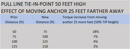

How much does anchor distance from the tree matter?
Not much!!
If tree is 100' tall -- with TIP at 50' -- and anchor a minimum safe distance away of 100' -- moving the anchor back another 50' only increases the pulling torque 6%.
In other works, get your anchor a SAFE DISTANCE away, and it's not worth the effort to find a more distant anchor.
On the other hand, with anchor (or redirect) closer than TIP height, torque is greatly decreased.
