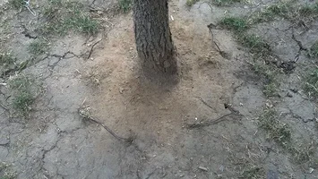

Take it off... Take it all off... I cannot see anyway that leaving it would help out at all. The attached image is of an ash in Toronto. That basket it really rusting away
