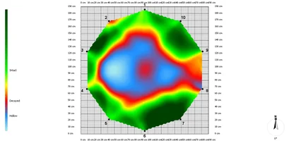

On one job I took a ~11" branch off and sealed the wound with Lac Balsam. Annual recoating lessened cracking for a while; the house changed hands and I haven't been back lately.
