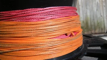

An economical means could be to cut your old line in half, cut your new line in half and splice (not knot) the lines together with each other, you have then, two identical lines, each half n' half because honestly, the first half of a 60 meter line is doing all the business. You now have two entire full-length shotlines, each with new leads. Good mileage. I'm running half n half on a reel, and half n half in the cube. You can see by the image why I said to connect together with a splice, not a knot. Red is Zing-It, orange is fling-it; same material (dyneema) but slightly different construction. The orange appears, and seems to be slipperier.
