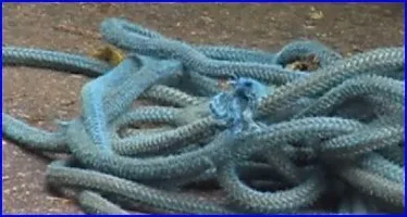

looked like the rope he was climbing on should have been retired a couple years ago. The rope also looked like it was the true blue made by samson, i heard this rope is supposed to climbed on and used for light rigging operations? Correct me if I'm wrong.
Samson sells it as climbing line, see image:
I haven't heard of anyone using it for that application in years, though, as climbing line construction and selections have come a long way since True Blue's heyday. It makes a great rigging line, though. Durable and pliable with just enough stretch.

In the news report, they show the rope where it "broke". In the news video, the rope appears to be cut. When a rope breaks, there is NOT a clean cut. When it is cut, it looks different.
-Tom
Thanks Tom, wasn't sure because of the construction of the rope being without a core.
