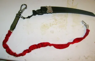

I take my Zubat up with me on every prune. I made a lanyard for it that clips right into the hole under the blade and the sheath is clipped to the lanyard to keep the blade from snagging my ropes.
