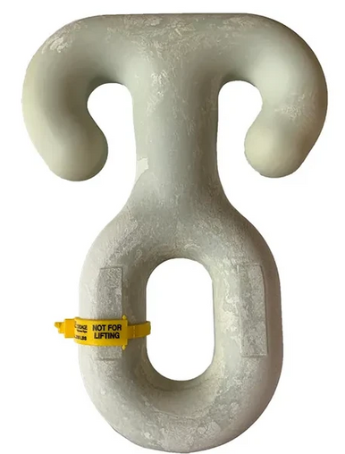

Plastic Hook for Chipper Winch
I work for a gov. outfit and I need to keep this winch simple. Although I have lots of experience with knots, winch lines, and heavy duty tree work, my coworkers cannot say the same. I need to keep it simple and replacing a metal hook with a composite hook is really the only way to solve my problem. If I tried to show them a slip timber hitch or a stick toggle, they would walk away and never use it. If someone learns a way to teach old dogs new tricks let me know.

I’m putting this link here for anyone else who has an incredibly hard time finding one of these like me.
Gap Arborist Supply also carries them.

We have a Bandit 19XPC and our feed wheel is locked until the winch line is stowed. I like this safety feature, but we still use a Chook.
This is what we have on all our chippers but I actually prefer a timber hitch.
I actually really like my Chook, very simple to use. Splice or tie a longish loop, and feed it through the closed eye at the bottom then around the load, and slip the loop over the two hooks.
