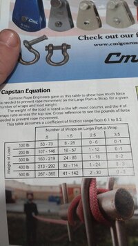

Bart said: "Still waiting for someone to calibrate a porty for tension ratio vs wraps. Its exponential."

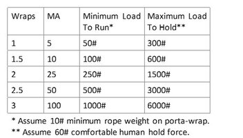

I have developed my own rule of thumb for porta-wrap friction. Maybe it will be helpful to someone.
It obviously has to make many (too many) assumptions. But I still find it useful.
Here are my "rule of thumb" weight ranges for different wraps: [See PortaWrap Load Ranges. JPG]
This calls "One Wrap" when the rope comes in the porty at the top, goes under the porty once, then around the post on the top to the groundsman.
This assumes a Coefficient of Friction of 0.25 for nylon rope on aluminum porta-wrap. Ropes can vary a lot, higher and lower than this amount.
Reading the chart - If I estimate the load will be 125#, then 1.5 wraps might work, but groundsman would have to have a very light touch on the rope or the load won't run at all. For 125# 1 wrap would work much better, meaning it's easy to let run and easy to stop the load and hold it.
For those who want more precise measurements, here are the actual percentages, then how I fudged them to make them memorable.

Love these visuals for RELATIVE capstan friction. I am trying to figure out what the "Degrees" column represents in the bottom chart. Thanks
I probably should have left the "degrees" column off to avoid confusion. In figuring friction of a rope going around a bollard or cylinder (in our case, a porta-wrap) what matters is the number of degrees the rope is in contact with the cylinder. So a 'half-wrap' is when the rope contacts the porta-wrap half of a full circle, or 180 degrees. Full wrap is 360 degrees.
No that totally makes sense now! Thanks for the explanation! I can see this help further explain friction to new ground workers!
Then if your groundsman is a math geek like me, he'll probably object when he notices that a single wrap only touches the main part of the porta-wrap for 270 degrees, not 360 degrees. At that point you can thank him for noticing, compliment him that he has a promising future in tree work because math and engineering and details matter. Then calmly point out that the contact and turn around the smaller cylinders count also. The almost-90-degrees turn around the exiting post plus the very minor turn around the entry loop on the porta-wrap provide the additional 90 degrees. So, 270 + 90 = 360 degrees, one full wrap.
Agreed! Also as you have stated previously, rope diameter and construction are factors too! Even the diameter of the bollard plays into it too!
Yes, the rope construction makes a difference in the amount of friction. Nylon is different from polyester which is different from amsteel. And for the same rope it makes a difference whether it is clean, wet, dirty, or sappy. Then for the porta-wrap the kind of metal makes a difference and whether it is clean or not matters.

I call your Mechanical Advantage a tension ratio as I found that whatever the instantaneous values were they always maintained a constant ratio. and hence the term.
Bending of the rope is ignored in the (exponential) capstan equation. I have some measurements using various diameters of biner etc in a 180 degree configuration in Base tied SRT tip forces thread you can use for reference.
A porty model could be made including the smaller fairlead diameters. Calibrating includes all the effects in one fell swoop hence my interest. Removes the uncertainty of modelling.
