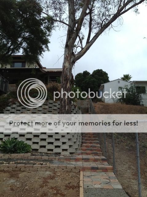

Tell me they didn't backfill the entire height of that wall.
The last time I worked for this client (about 2 years ago) they mentioned they may be getting some landscaping done in the future, I said 'make sure they dont disturb the tree roots or pile soil up around the base of the 2 firs'
Guess what? they put up a retaining wall and backfilled round the trunks with top soil.
Both in severe decline since the landscaping was done less than 6 months ago, We're removing them soon.

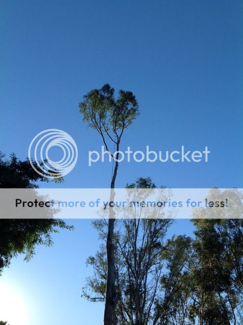

Mine will be set higher through a pulley with the rope's tail tensioned and locked off where ever I am cutting from below.
I like to take my own sweet time and move very slowly and deliberately when doing a solo removal. Logic and lots of forethought are a must.

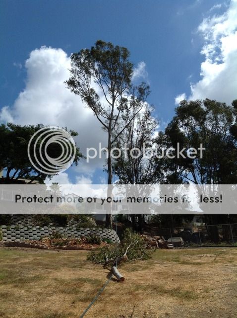

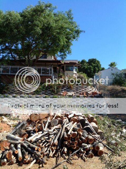

Well, the client's multiple cactus gardens were targets requiring a very high set pulley to clear them by a substantial amount while solo speedlining today.
This meant having to work the lower sections without the speedline, and that took most of the day. But I'm happy to say it worked out well, with no damage to anything, though it was very exhausting for an old orthodopod like me.
The client was thoroughly impressed with my work though, to the point that she hooked me up with her neighbor to remove a much smaller and considerably easier tree.

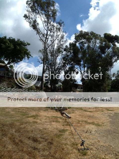

Mine is a modified Spencer Logging Tape with nylon twine rather than tape.
It clips to my saddle, allowing me to self retrieve either a fixed point lowering line, or speedline from over 50 feet away from the line's COG or anchor.
jomoco
It's the blue self retracting thing clipped to my old ragged saddle, with the round plastic shower curtain hanger that attaches to your lowering/speedline rope.
