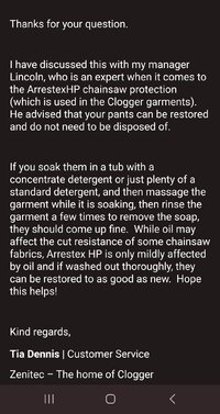

Oil soaked chainsaw protection
Just wash them in a front loader now that you’ve gotten the bulk of it off. I wash my pants in the washer all the time without problems.
In this litigious society of lawyers and idiots they represent, you might not get an official answer from Clogger. Misinterpreted and mangled words can make for problems when silence can be cheaper.
My bet is that you get a positive reply from @CloggerPete :)
So, I figured I'd get a response today, since NZ is so far ahead of us in "time".
Another two full washes, with two rinse cycles after each, by hand as advised, and it is looking a surprising amount cleaner still. I don't think it's reasonable to hope such a collection of fibers will ever be washed to as clean as new, but I am comfortable using them for work again. Thanks again everyone.
