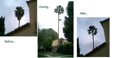

Here's a pic from another palm I did on Thursday. The boss called this a Mexican Fan Palm. I think it's a Washingtonia robusta or a Washingtonia pilifera fwiw.
Ladder to the first 25', then spiked up 25 more feet. THis tree hadn't been trimmed for 4 years. I crawled up under the skirt. It woulda been KILLER hot under there, but it was super breezy that day. I've read a few times times that people have died or passed out from suffocating under those things, but the breeze kept my oxygen supply sufficient!
Well, here's how it turned out....
