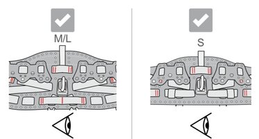

Noticed that the size small will have less accessory holes than the M/L
