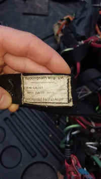

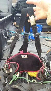

I too, like many of yous, am a skinny climber & run a TM. over the time (prob 5+ yr) I've been using it, I also have found that I'm more comfortable with suspenders to share the weight load, even just with an 020.
This is the suspender solution I came up with... just paracord with stopper knots and the cheap elastic Buckingham suspenders
