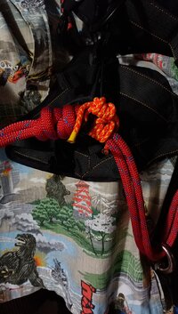

Replying just cause I have the onyx and think it’s similar to the MB.
Does just fine, I flipped my rigging plates and roll with two bridges, one is adjustable. I also tend to clip my chest harness to my bridge ring and makes for a super upright position.

I use the roll’n’lock zip tied on one bridge, my ring goes through both. Grab the tail and suck it in, and when at my work station just slack it out.
I found I like it only sucked in on ascents, so not aiming for extending it beyond my normal working bridge. Sometimes on long limb walks I’ll suck it in a bit to keep the hitch in easy reach.
Are those life support rated zip ties? Asking for a friend
But seriously, that makes sense, and it makes me think I might start using that "belay loop" thing on my saddle for longer ascents again.

When I replaced my bridge to make it a double last month I tied some accessory cord in a prusik around both. The mismatch in size let me use a 4-wrap for the same grip

Ha! Yeeeeha. The zip ties just hold it in place, I have a carabiner through it too but it’s a screw gate and do want to get around to see if a screw link could fit. It’s the old Mumford adjustable bridge with a little bit of a spin. Nothin fancy, it’s backed up, and the roll’n’lock acts as a mechanical knot block.
